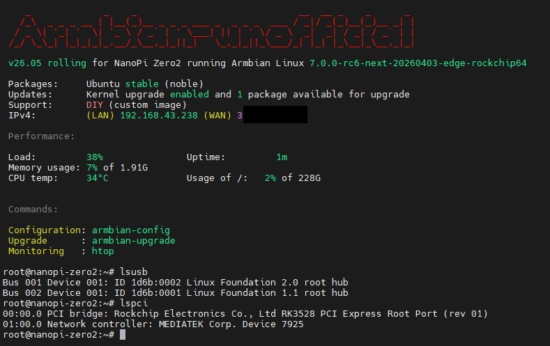

OK finally I was working with kernel version 7.0-rc6
Some tests made by myself:
- initially image was loaded from SD card and next placed on SD with USB stick (USB checked)
- Armbian image was written to eMMC 256G and now it is booting from eMMC

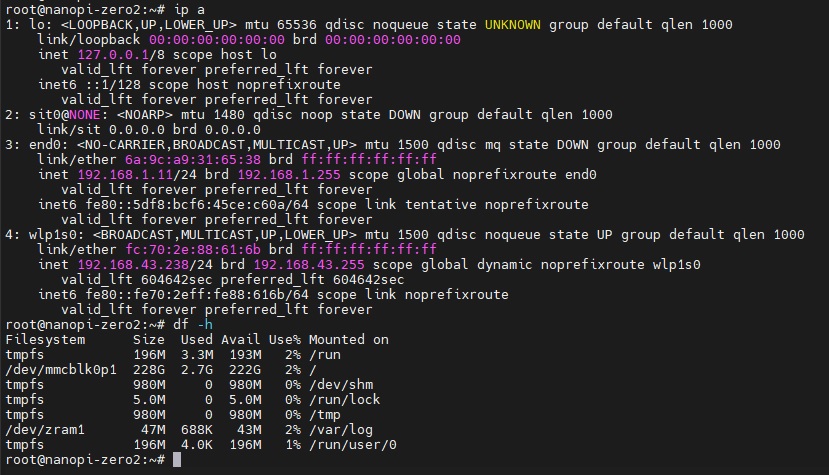

- Ethernet end0 was checked locally with link to my laptop
- PCIE was checked with my wifi card is Mediatek 7925 as internet connection works too
