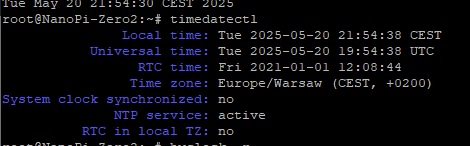

4. RTC before:

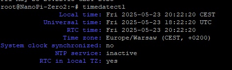

8. RTC after

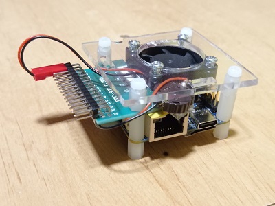

9. Overview image
