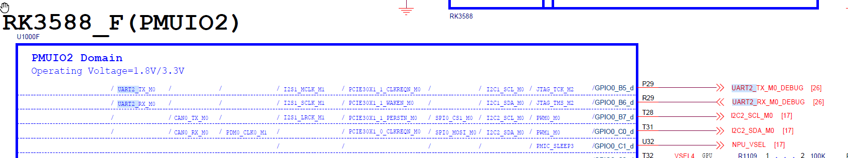

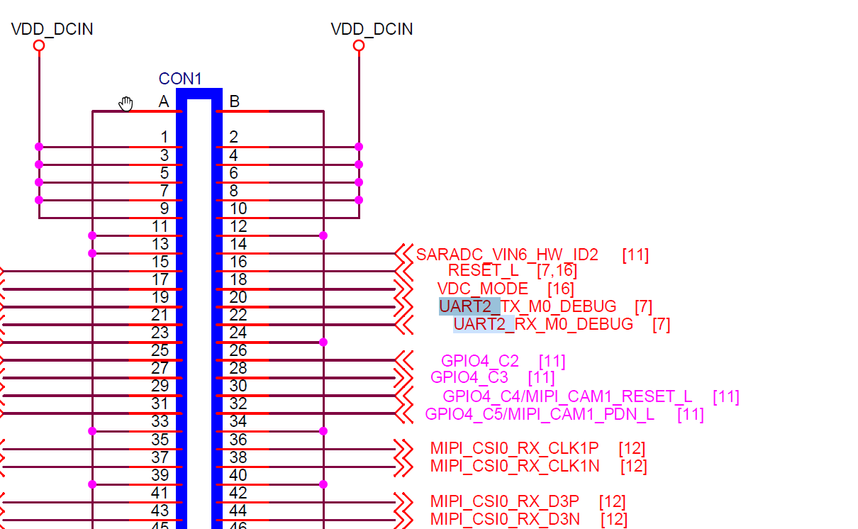

The Serial Setup - 1500000 8N1 prints garbage values on the serial monitor.

    3. I cannot properly see the connections in the schematic, nor do I have any documents showing the inner UART diagrams. So without that CPU Reference Manual you can't know how the clock is used for the UART.
