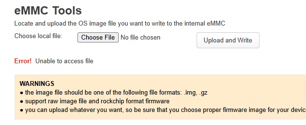

Problem loading rk3528-sd-debian-bookworm-core-6.1-arm64-20d
Followed these instructions: https://wiki.friendlyelec.com/wiki/inde ... n_Web_Page
  • Loaded FriendlyWRT from downloads page onto SD card
  • Inserted SD card in NanoPi Zero2 (2GB RAM. 32 GB SSD)
  • Booted NanoPi
  • Logged into 192.168.1.1 -> OpenWRT
    (BTW - had to change language from Vietnamese -> English)
  • System > eMMC tools >
    Select the rk3528-sd-debian-bookworm-core-6.1-arm64-20250811.img.gz file
  • Upload & Write
  • Progressed OK
  • But got error screen attached
  • Power down > Remove SD card > Power up
  • System LED = On Solid. No LAN activity (LAN Link not UP on switch)
What did I do wrong?
Did you ever solve this issue? I have tried installing this image with the maskrom flash thing but that didn't work either. Seems like I've wasted money buying from this company, don't reply to emails and their install guides are lacking or wrong, images missing from the download folders etc.. Very unhappy about this purchase.
