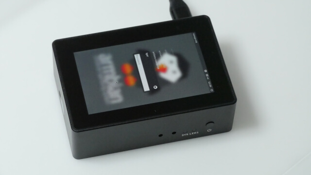

- The casing is small and holes for the wifi are not predrilled, installing wifi with the ipex connectors is a hassle since they they are not preinstalled and the M2.E ard is a tight fit (the T6 has 4 pre-drilled holes for antennas and much more space).

- A small item: the leds also work as intended. I was looking at a good way to make use for the user-led though.
