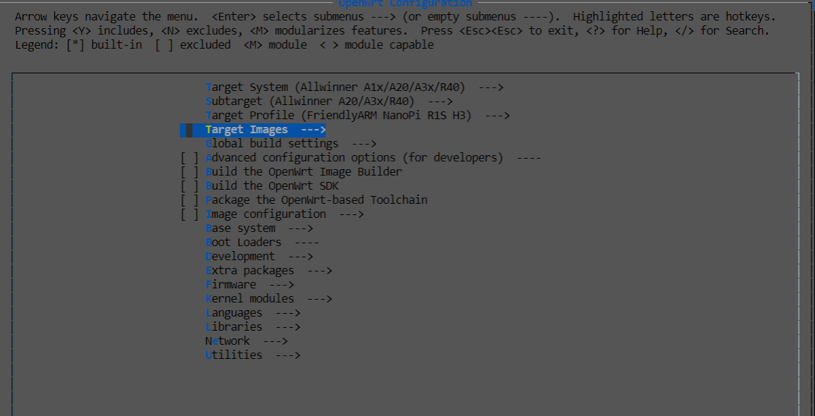

https://github.com/jayanta525/openwrt-n ... -r1s-h3-h5
Here is the source code for openwrt with NanoPi R1S-H3 added.
Follow the normal procedure of compiling OpenWrt.
You can also use Github Actions to compile builds:

Thanks ... i dont have x86 with linux ... so yestrday i start building on RPI4 (my first build openwrt :-D ), image are done. Today i will test them if they are OK.
I hat little problem on start because i overloked the diferent branch on GIT. But at the end i find my way eventualy.
