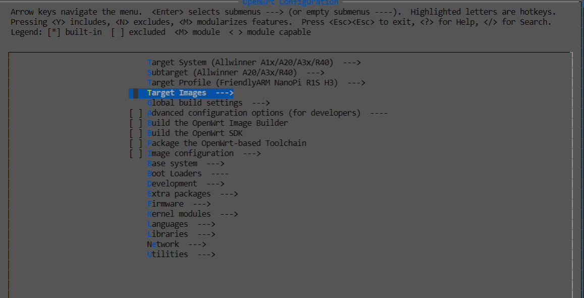

https://github.com/jayanta525/openwrt-n ... -r1s-h3-h5
Here is the source code for openwrt with NanoPi R1S-H3 added.
Follow the normal procedure of compiling OpenWrt.
You can also use Github Actions to compile builds:
Annotation 2020-06-01 193218.png (121.93 KiB) Viewed 23807 times
