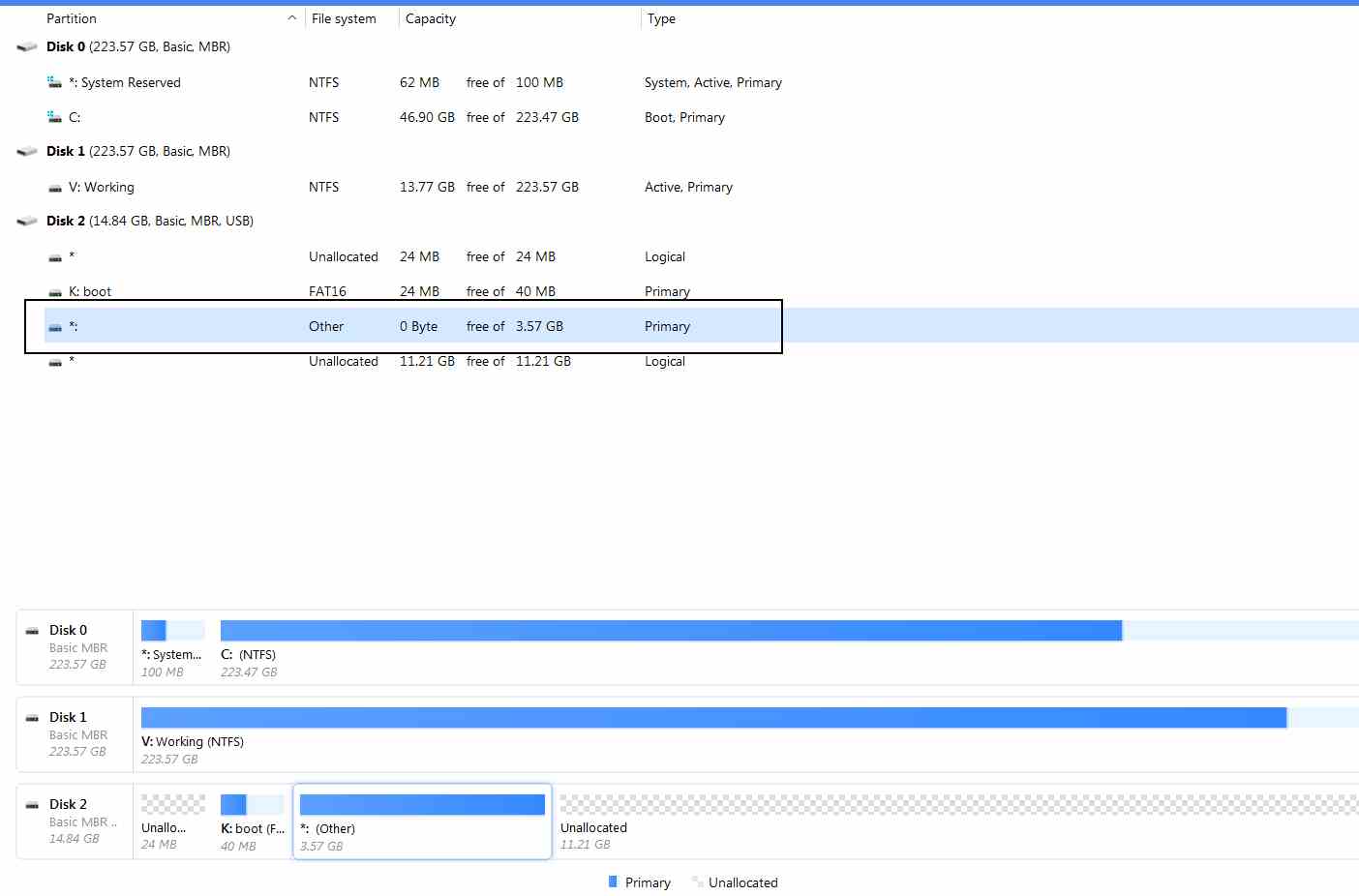

I'm attaching a screen shot of the EaseUS Partition Master.
Also here i can't extend the size of the partition more than 3.57GB
In this case i guess that nano pi prepared a limited img for this os.
More than that, i see that the partition file system s Other, but in other tool i see it ext3 and when i connect to the sd when it's running on it's machine i see that it's ext4. i believe that the original img file is corrupted. probably someone from NanoPi can help?
