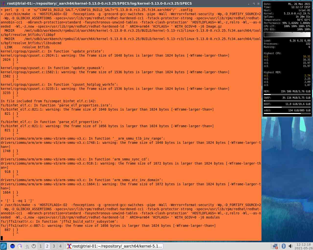

The same goes for me, but I'm also building the kernel package on the second desktop at the same time.

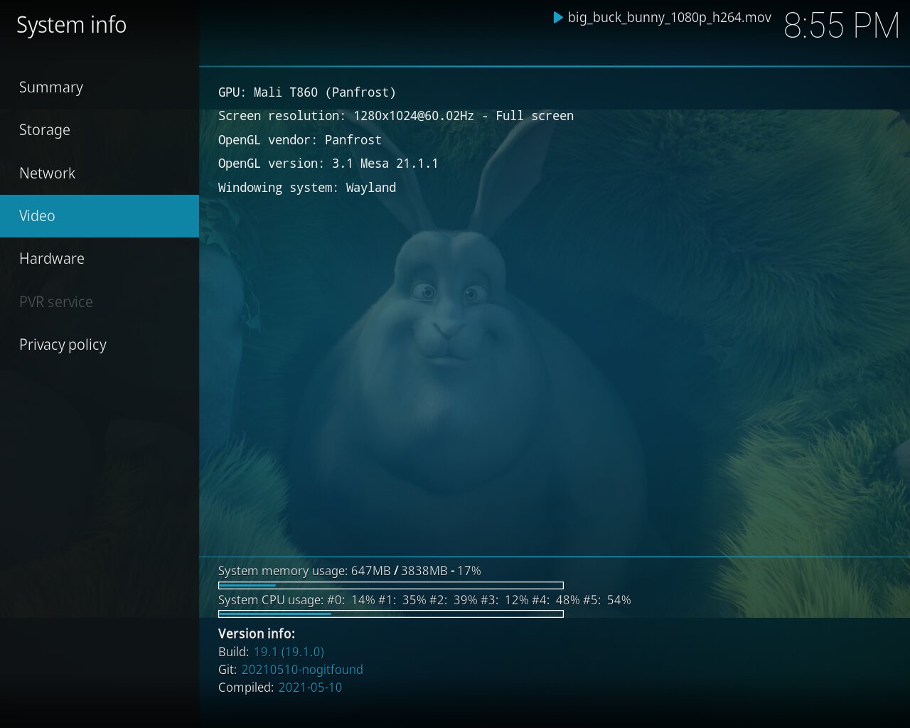

Running on Wayland gives a nice performance boost.
[lxqt@trial-01 ~]$ glmark2
    glmark2 2021.02
    OpenGL Information
    GL_VENDOR:     Panfrost
    GL_RENDERER:   Mali T860 (Panfrost)
    GL_VERSION:    3.1 Mesa 21.1.1
                                  glmark2 Score: 107
[lxqt@trial-01 ~]$ glmark2-es2
    glmark2 2021.02
    OpenGL Information
    GL_VENDOR:     Panfrost
    GL_VERSION:    OpenGL ES 3.0 Mesa 21.1.1
                                  glmark2 Score: 182
[plasma@trial-01 ~]$ glmark2
    glmark2 2021.02
    OpenGL Information
    GL_VENDOR:     Panfrost
                                  glmark2 Score: 594
[plasma@trial-01 ~]$ glmark2-es2
    glmark2 2021.02
    OpenGL Information
    GL_VENDOR:     Panfrost
                                  glmark2 Score: 615

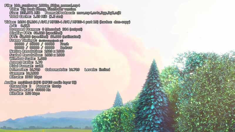

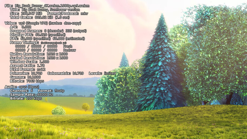

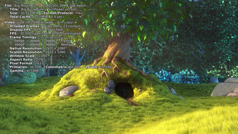

I have now ffmpeg with these patches applied in place.
External libraries providing hardware acceleration:
cuda                    nvdec                   v4l2_request
cuda_llvm               nvenc                   vaapi
cuvid                   opencl                  vdpau
ffnvcodec               v4l2_m2m                vulkan
But as I don't know how to verify the hardware acceleration, I'm not sure if something else is also required.

VP9 support has just landed in media staging, i.e. is in flight for 5.17.0. I moved to 5.16.0-rc2 with media staging patches applied.
"mpv --hwdec=auto --hwdec-codecs=all ${MOVIE}" successfully supports various hardware accelerated codecs (hwdec: drm-copy):

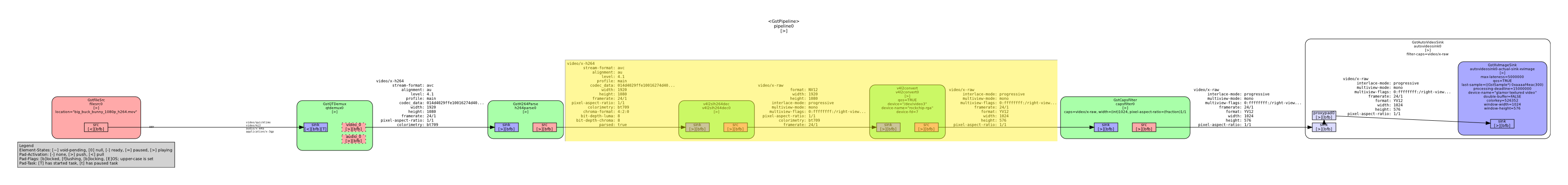

Gstreamer main branch has just landed VP9 support, i.e. 1.20 should have it out of the box.
