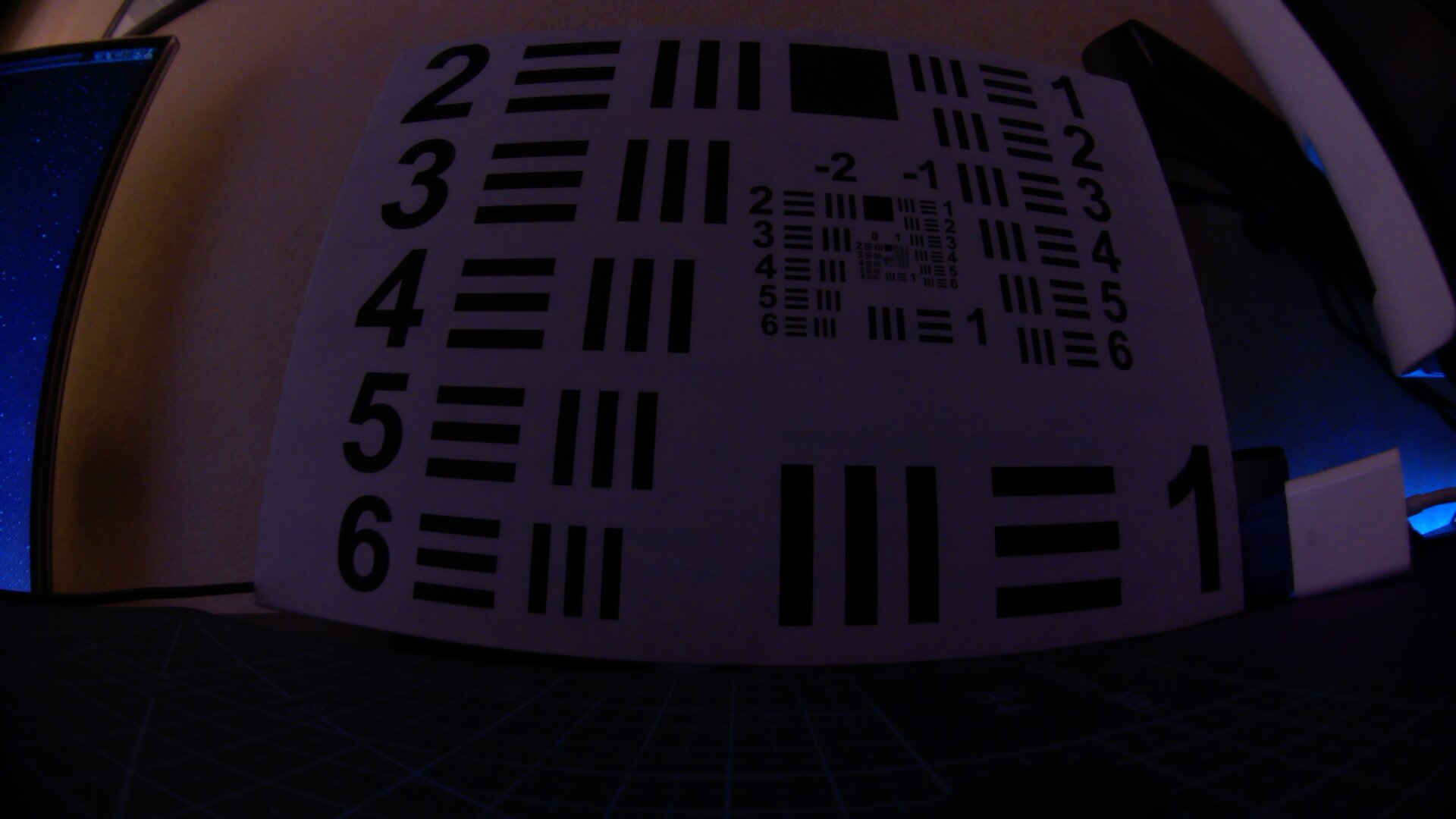

I use the MCAM400 with a nanoPi M4 (image rk3399-sd-friendlydesktop-bionic-4.4-arm64-20201027).
Image is very dark when there is not much light so I think there is no AEC or AGC.
Do you know how I can enable it if there is ? Or do you know how I can access to registers to set gain by myself ?
Thanks for your help.

I changed the lens to have more angle and with current image (rk3399-sd-friendlydesktop-bionic-4.4-arm64-20201226.img.zip), camera output is very dark (photo in attachment).

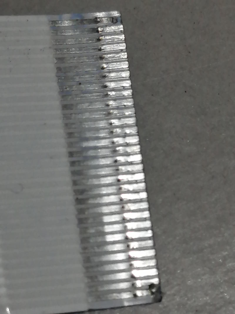

Unfortunately, I can't make the camera with IR cut works with 4.19.161 and the mainline kernel.
That's why I asked you which camera you tested with. the Camera w/IR cut filter worked fine with FE 4.4, maybe I have damaged the sensor removing and inserting it many times.
I get this error:
[ 72.944191] rkisp1: MIPI mis error: 0x0000000e
I get this error:
Looks like I have a camera with IR cut (normal colors, price 12.99$).
Maybe your IR-cut camera is really damaged - IR filter affect colors result, but have very little effect on brightness (10% from F2.2 vs F2.0 for this camera).
Just for the record, i just received a new sensor and found out the error reported here is due to a short on the last track of the FPC, luckily the sensor was not damaged. Changing the FPC was the fix.
