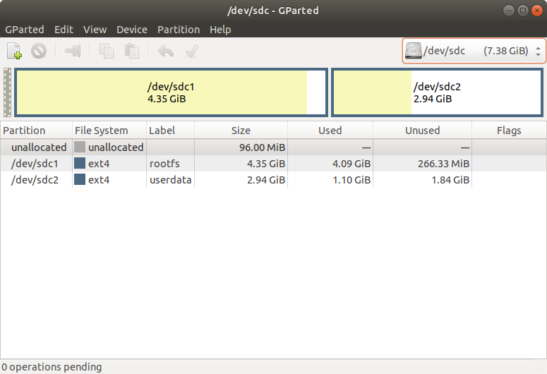

Yes, I think too. I suspect that the first "unused" memory area contains raw data :
