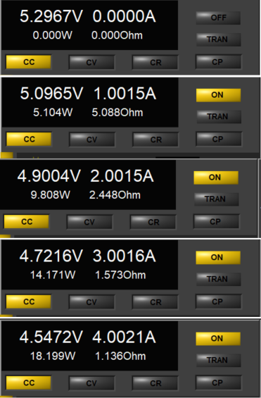

What is the current capability of your Apple iPhone charger and what voltage does it actually put out when on load? Most phone chargers have a significant voltage drop when you load the output. They are not the ideal supply for any of the boards.
Even a so called 5V 4A supply I recently purchased to power a Jetson Nano failed and the board would reset or hang. I stuck it on my DL3021 digital load and found that it had poor voltage regulation at anything over 1A. At the 2A load, around what the board was taking, it was too load and the board would crash.
