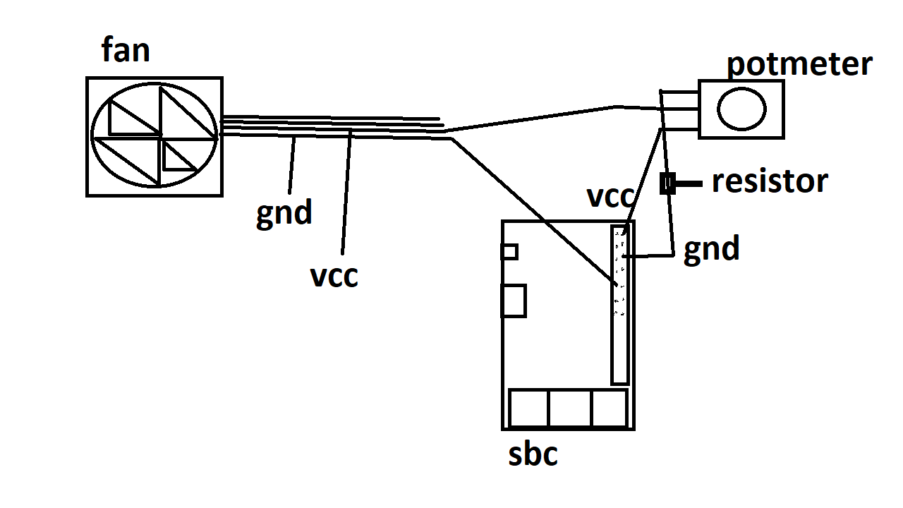

Yes and maybe it is true. I'm also no expert. But you could short your board if you do this wrong. it can't hurt the board to mix 5V with 3.3V to a common ground. But I don't think the fan will work properly. It depends on how the fan reads the pwm.
There is a way to do this safe and good, but again, it's not simple as pi ;)
You would need to make a circuit board, but I'm not sure of the components, and I can't find a good example.
What's imo much easier to do is put a pot meter in between the fan and the 5V gpio. Then you don't need the pwm to control the speed, but you have to turn it higher yourself when it's needed.
For this you MUST use a resistor or YOU WILL short/burn your board and potentiometer.
There are 3 pins on a pot meter, one end is ground, the other is vcc. The middle pin is where you would need to connect your vcc from your fan. Then ground from the fan also goes to a normal ground.
I've made a very pretty drawing of this.
You could then paste the pot meter to the fan so they're a whole.
But again, I'm also no expert. I'm a hobbyist who makes (a lot) mistakes himself.

Thank you NicoD, I haven't tried your solution yet but it has helped me a lot,
