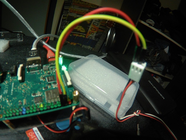

You can use this fan if you use jumber wires.
The black wire is negative, and the middle wire is positive.
Then connect negative wire to ground, and the positive to a 5V pin.
Like this.
