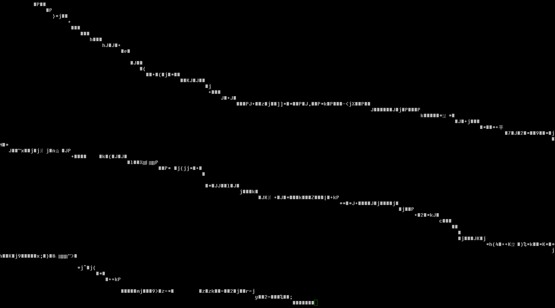

Thanks that is exactly what I did. Without HDMI cable connected I am getting gibberish output on serial as shown on attached image. My serial settings are (same settings work fine with for example nanopi core2):
speed: 115200
Data bits: 8
Stop bits: 1
Parity: None
XON/XOFF
Funnily board seems to be coming up, I have also green led blinking of reading from sd card. Do you know any other settings?
Gibberish usually indicates a missing ground connection.

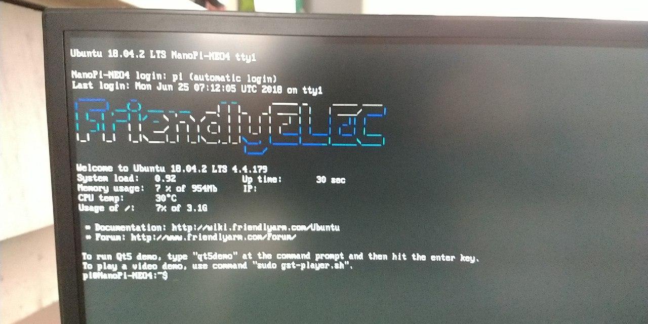

ok now I am completely baffled. After finishing the boot on serial with gibberish, I have connected HDMI cable and I get the image. Just for information I have serial 2 USB cable from Adafruit with CP2102. I am going to test second board.
it happens with or without ground
It all sounds like a ground issue. I assume you are using a 3.3V TTL serial interface to connect to the debug port?
yes it is 3.3V USB to TTL cable from Adafruit. Specs are here:
https://www.adafruit.com/product/954
When you connect to the board, do you just connect GND, RX and TX?
You don't need the 5V connection as your board is powered elsewhere. Better to leave this disconnected to avoid shorting power supplies.
Hi v8dave,
sorry for not replying I've been busy on other project. Today I had a chance to retest everything. As for your question, yes I did not connect 5V it was only RX,TX and GND. Conclusion is:
not compatible USB-C power supply
I have connected to USB-C psu of my laptop and it was same stuff (rebooting), then I disconnected USB-C power and connected only on USB to TTL cable. Suddenly whole thing boots. Then I've got another USB-C psu brick from my phone and voila it worked like a charm. I've tested all important functions like wifi, video playback and so on, all seems to be working.
NOTE: however serial debug output stays garbled (something must of been damaged) but board as such works and boots ok.
