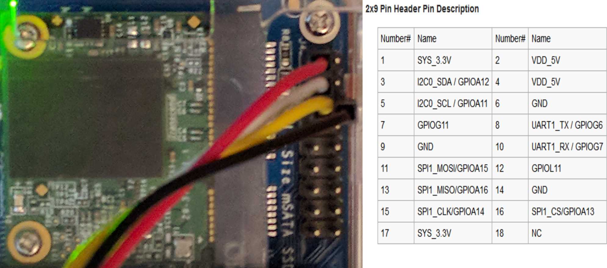

First take a look at the NanoPi Wiki, because we must know which I2C Bus we are using with the 2x9 Pin Header.
NanoPi Duo 2x9 Pin Header smaller.jpg (124.49 KiB) Viewed 40661 times
OK, we are using I2C0, this is Important to know, because in Python Scripts written for other Computer, they may using an other Bus. If I2C1 or I2C2 is addressed, we have to change the Script to I2C0.

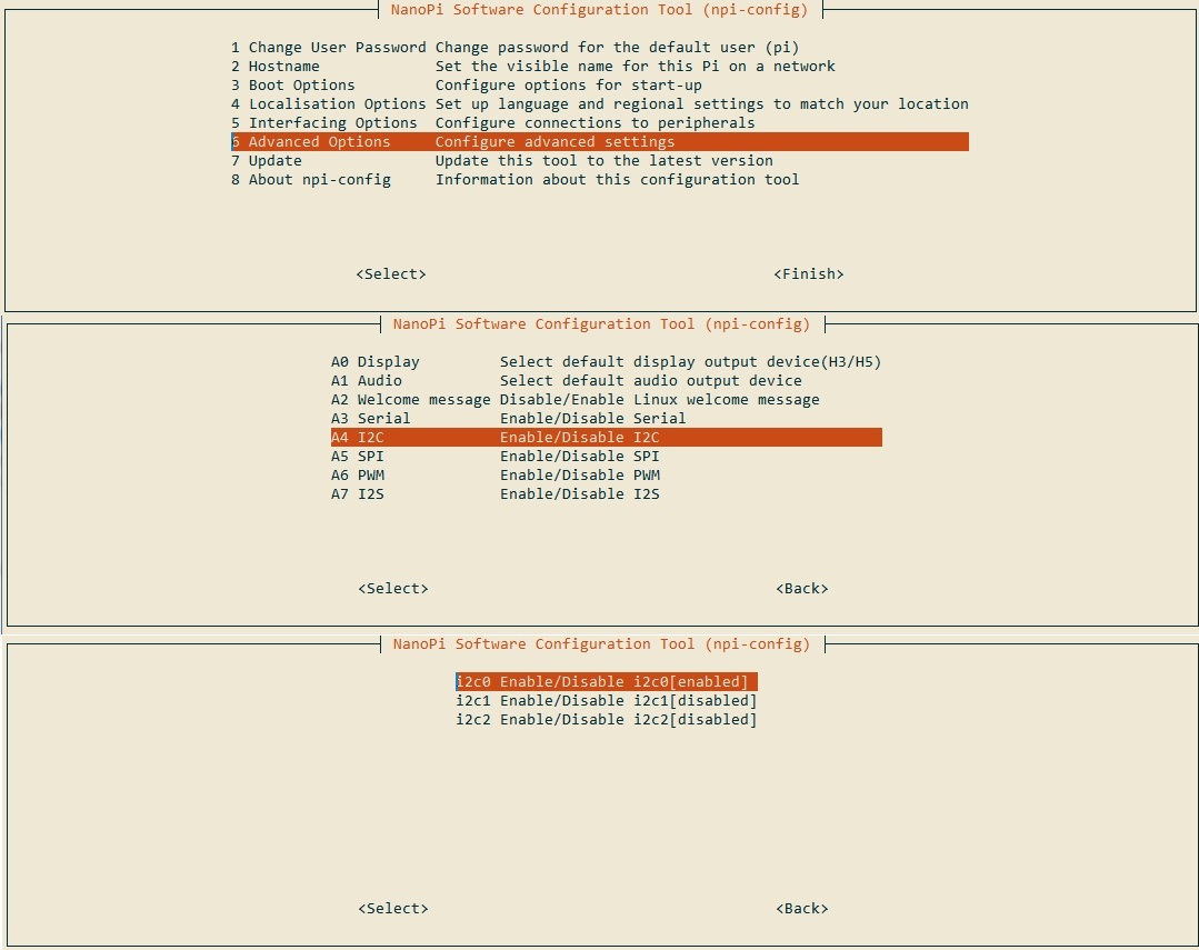

Now we take a look at the NanoPi Software Configuration Tool (npi-config), because we want to know I2C is enabled, or we have to do so.
sudo npi-config
First select 5 Advanced Options, then select A4 I2C and last select i2c0 Enable/Disable.
npi-config I2C.jpg (149.03 KiB) Viewed 40661 times
If i2c0 is enabled, you can leave the menu. otherwise enable it and reboot.

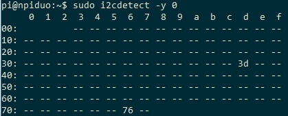

If we have installed one ore more I2C devices on our NanoPi, we can check there addresses out now.
pi@npiduo:~$ sudo i2cdetect -y 0
(Address 76 is a BME280 and address 3d is a Char OLED.)
