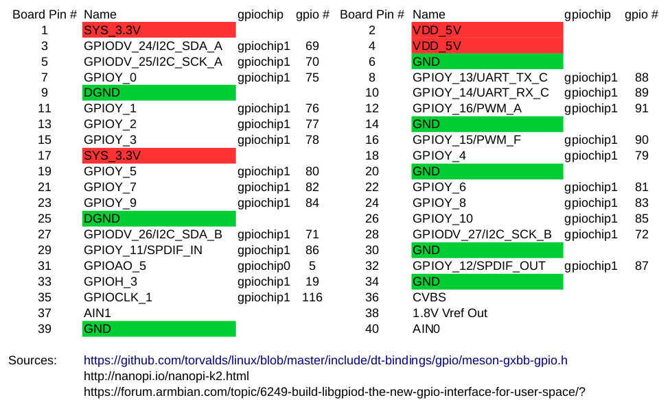

I'd like to connect button LED ... to GPIO. I d'ont have the gpio unix name.
For example we can see it in the array for Neo board :
http://wiki.friendlyarm.com/wiki/index.php/NanoPi_NEO2 ''linux GPio''
I dont see this information in :
http://wiki.friendlyarm.com/wiki/index.php/NanoPi_K2
Thus I don"t know how to use direct commands like :
echo "in" > /sys/class/gpio/gpioXXX/direction
Other solution : use the library :
http://wiki.friendlyarm.com/wiki/index. ... edirect=no
But K2 seem not to be supported:
https://github.com/friendlyarm/WiringNP ... 4b3516fd75
The question is simple : how to have gpio number/position information? I dont see it in schematic.
My initial aim is to use the power key button to halt K2 board without any display.
Thanks for your help
I had the same problem. Here is the pin layout I came up with:
