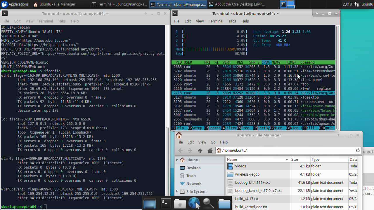

I have been evaluating some modern kernel for the A64 and while mainline kernel 4.17 isn't ready i worked on linux 4.4.111 with bionic and xubuntu and gave it a try.
This is not BSP (although based on) but rather u-boot passing a Flattened DTB to the patched kernel to give some idea about the progress and what works so far:
* Gbps
* Hdmi
* hdmi sound
* DVFS
Need some fix:
* RTL8189ETV sometimes works, still unusable.

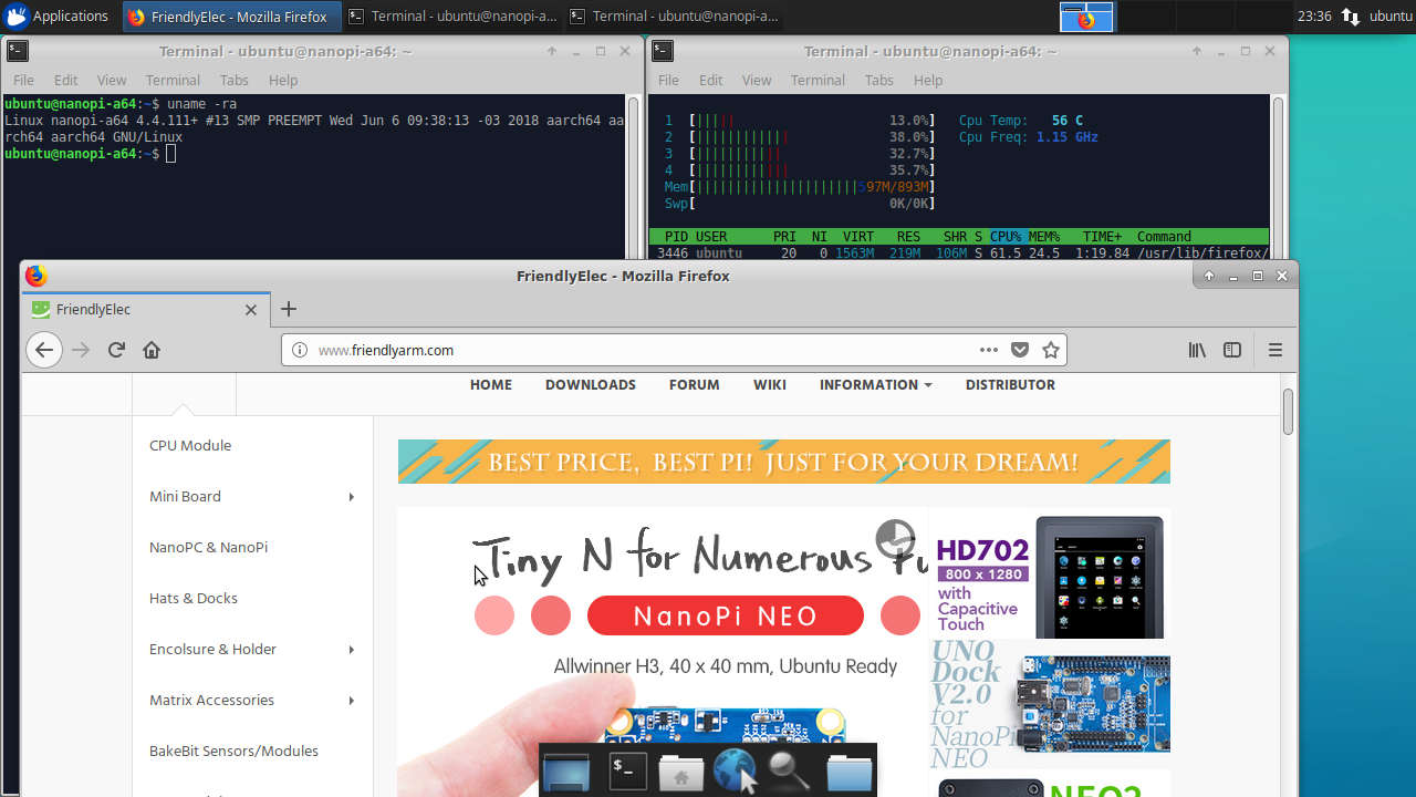

As you can see, firefox is memory hungry application, add this to the bionic and 1 GB mem is almost full.
[attachment=0]a64_kernel_4.4.111_2.jpg[/attachment]
[attachment=1]a64_kernel_4.4.111+.jpg[/attachment]

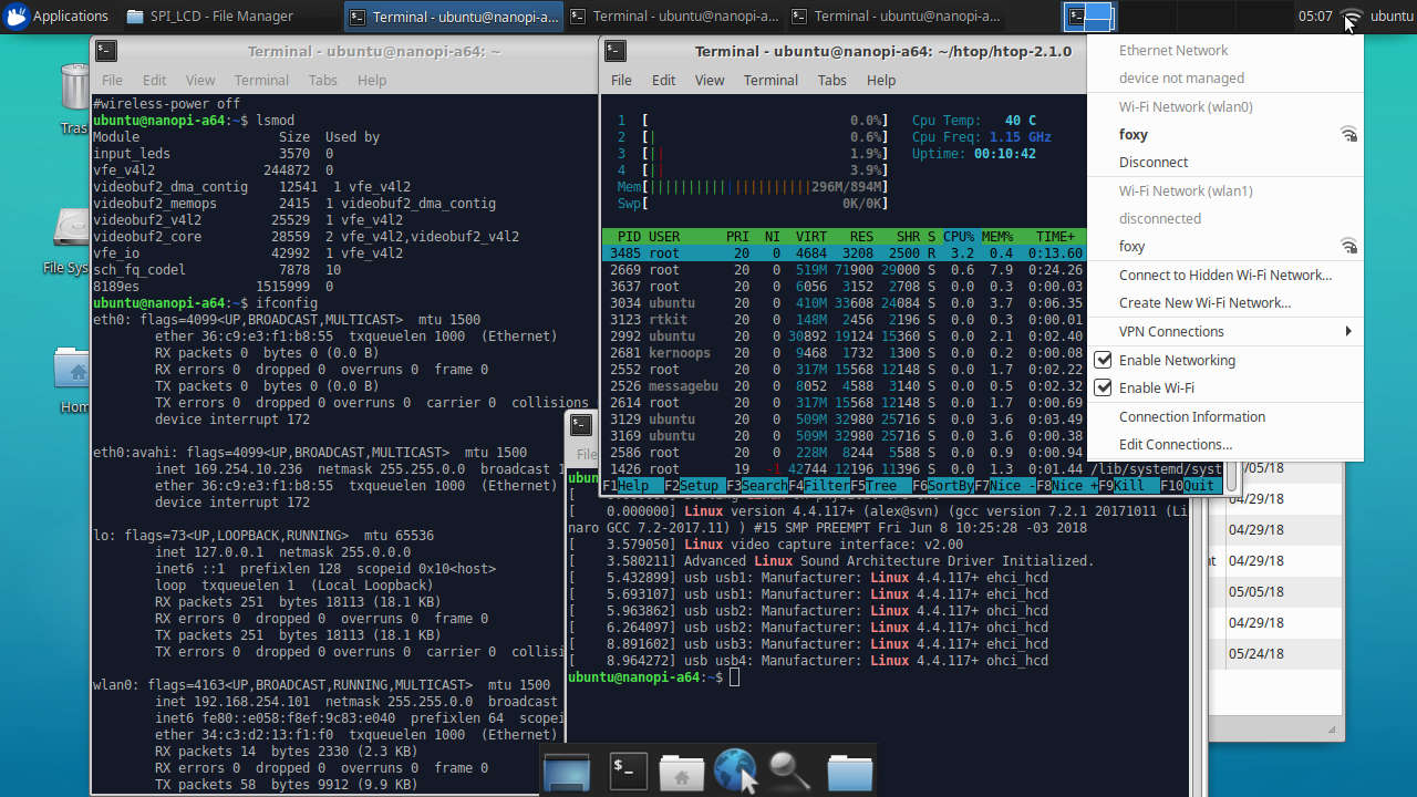

The RTL8189ES driver has been fixed for kernel 4.4.117, it is working fine on a few tests here. I will push the source code to github after proved stable.
[attachment=0]wifi_rtl8189es.jpg[/attachment]
A little follow-up, I was expecting a punch on Gbps for the kernel 4.4.117 but got the usual speed on gigabit port, the good news, the new 8189ES driver really unleashes the power of RTL8189ETV, here are some benchmarks:
