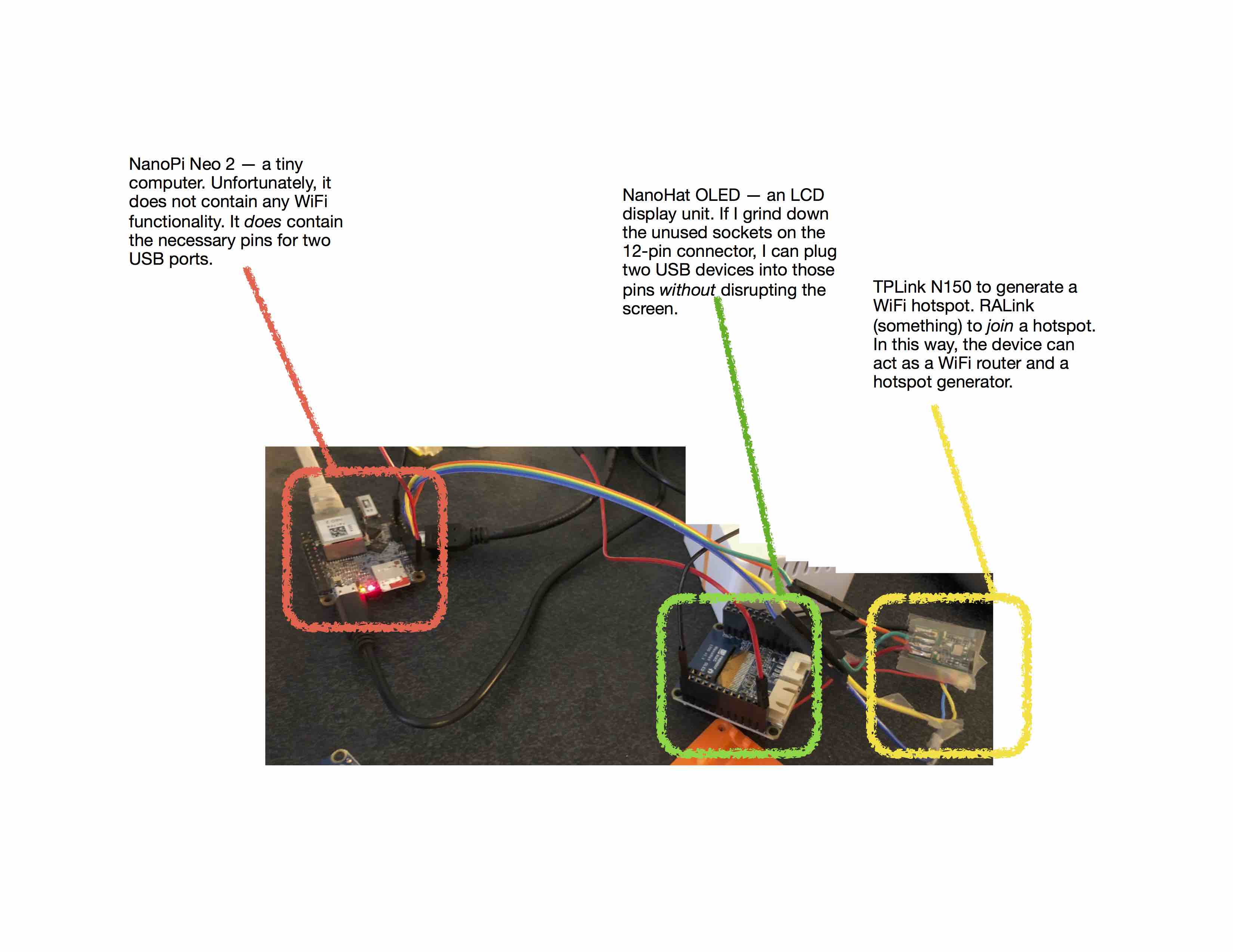

As you can see below, the device is not quite finished... but the two WiFi adapters work. I'm trying to figure out how to attach them permanently. Anyway, the only problem remaining (other than the dm-crypt issue) is the matter of making hostapd recognize and use one of them as a WiFi access point. I'll get back to it.
