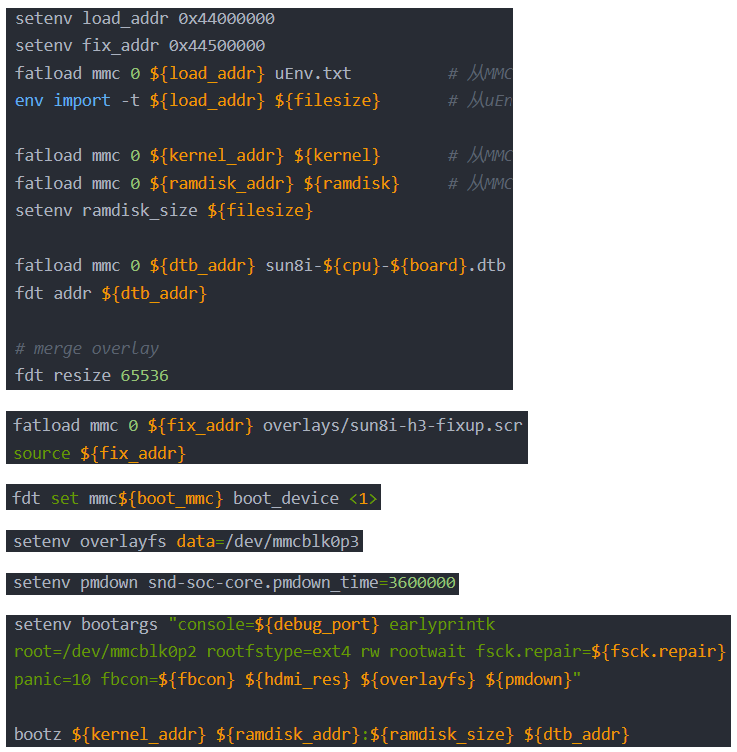

How did i repare the boot.scr
1) connect to device by Debug-UART
2) Based by article https://blog.csdn.net/qlexcel/article/details/122377077 i performed all strings of boot.cmd almost line-by-line like a picture. Yes device had starded!
3) Knocked to devise by WinSCP with root rights, and entered to boot folder.
4)
mkimage -C none -A arm -T script -d boot.cmd boot.scr
created new boot.scr from boot.cmd
After reboot, the device has started normally.
