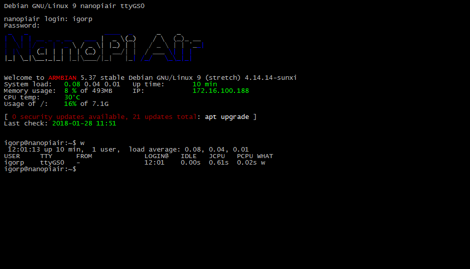

Bootlog: http://ix.io/EO6

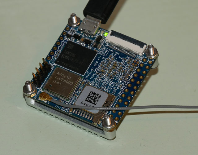

You can log in via microUSB serial. Just plug it to your USB port and a serial device will pop up on your host computer. It's not serial at boot time but you can login when system is up. Enabled by default.

Yes, but I also made a small mistake which prevented this working :( I manually enable USB OTG port while testing (within armbian-config), console popped up and forget about that. Now, this is fixed and the actual download image was tested - images at download were replaced, also for NanoPi DUO with the same problem. I don't know how this looks on MAC (USB3 port is recommended for powering, but USB2 will probably also work), but this way it looks on windows:
You can log in via microUSB serial. Just plug it to your USB port and a serial device will pop up on your host computer. It's not serial at boot time but you can log in when a system is up. Enabled by default.
