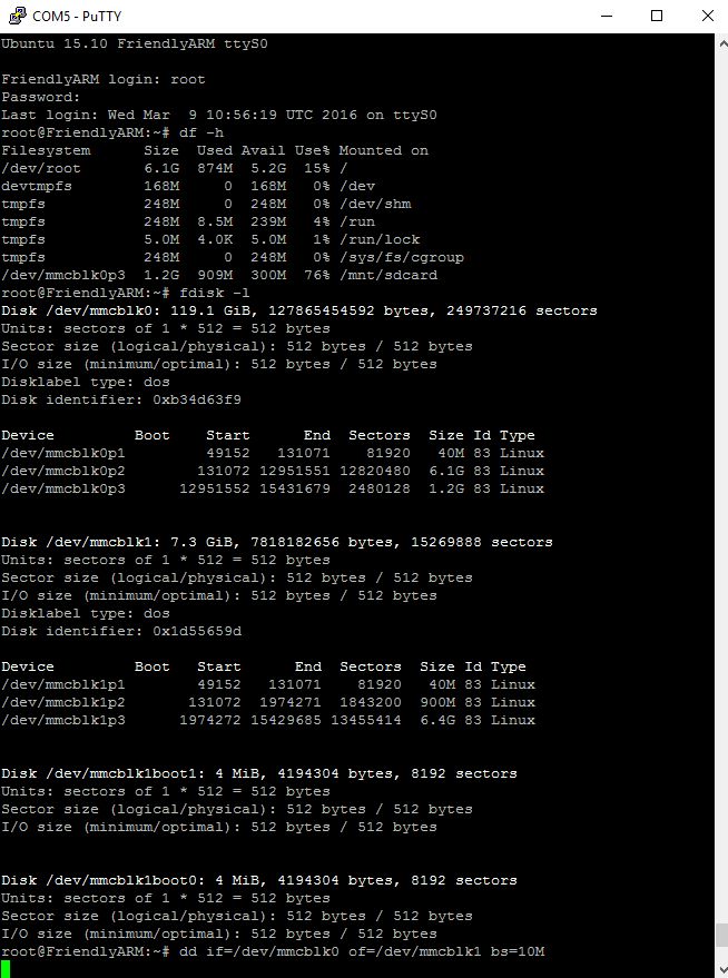

I never seen it do "OS will automatically resize the file system" it don't look like it works. I can see what it does because I am using the RS-232. So it should show it doing resize the file system.
I had to use a live GParted and then I made the 3RD partition small and the 2ND one made it big and now I can DD copying it to the eMMC 8GB now.
Can see it good with a screen shot of the RS-232 and it's copying it to the eMMC card now.
resized the nanoPi air.jpg (123.85 KiB) Viewed 20250 times
Nice to see /dev/root is only using 15% now not 100%!
It came back with this:
dd: error writing '/dev/mmcblk1': No space left on device
746+0 records in
745+0 records out
7818182656 bytes (7.8 GB) copied, 954.859 s, 8.2 MB/s
root@FriendlyARM:~#
Turn it off, removed the SD card and now it boots and still shows only 15% used on /dev/root. Now have to get WiFi working and can have room to update it.
