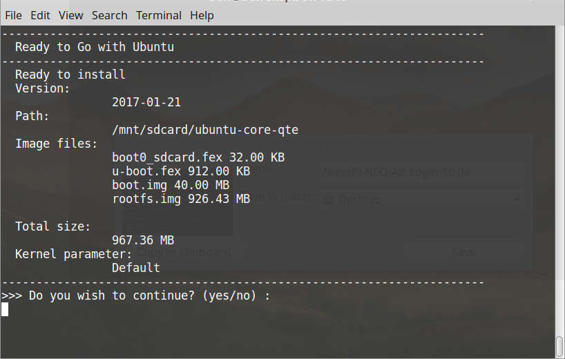

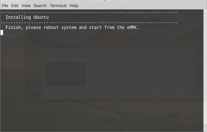

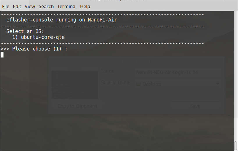

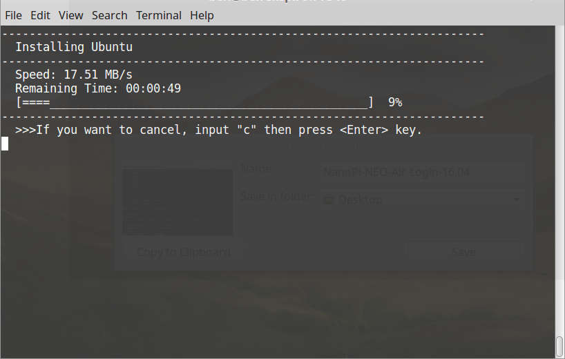

Hi, All
We have made a super easy flashing tools into eMMC already, the new "elfasher", the new ROM is uploading, will take about 1week. Please wait.
Or, you can download it from the China BaiDuYun, some slow.
Thank you

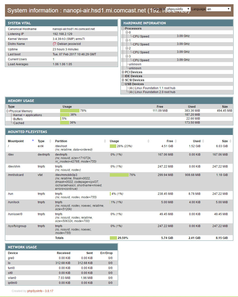

They should put that on the wiki then. All they have is eflasher then "select your wanted OS and type "yes to start flashing" But if you type it just get -bash: eflasher: command not found So they should update the http://wiki.friendlyarm.com/wiki/index.php/NanoPi_NEO_Air page.
It's like if you look for help on google that's the place it take you to the wiki. But it don't help what your looking for.
Never got it to work with the eflasher 8GB image to flash it's self to the eMMC. So like I said in another post I used Gparted to edit the SD card and made partition 3 the one it puts on /mnt/sdcard to only 1.18GB in size to the end of that partition then made the main / or the rest of the size so 6.03GB got it.
Now it don't say 99% full or even 100% used.
Here is a phpsysinfo screen of min how it looks now. Neat info to see on it.
screenshot-nanopi-air 2017-02-08 04-50-24.png (136.55 KiB) Viewed 37354 times
Can see the Mountpoint on this good how it's using the 8GB eMMC now.

I tired this but all you get in the terminal is:
  eflasher-console running on NanoPi-Air
  Select an OS:
    1) ubuntu-core-qte
>>> Please choose (1) :
The wiki says: "Select your wanted OS and type "yes" to start flashing. After it is done take off the card, reboot your board it will boot from eMMC. "
When I press 1, nothing happens.

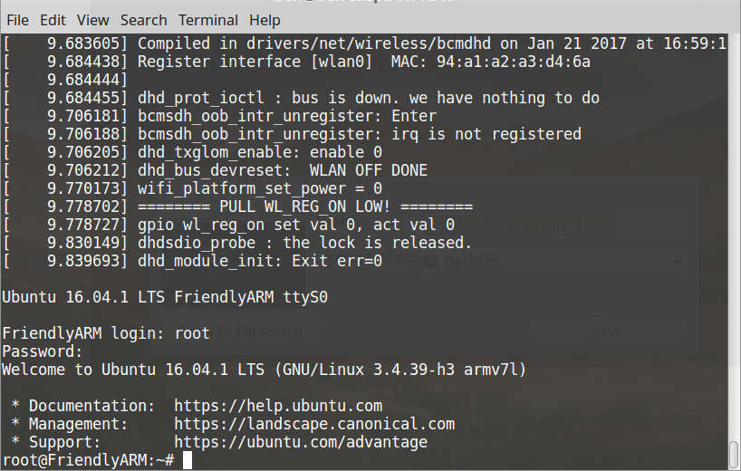

Hi, All
Here I post what I do successfully.
I use this ROM
[img]
[/img]
[img]
[/img]
[img]
[/img]
continued...
