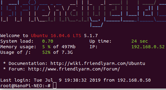

It may help you https://buildroot.org/
More serious http://www.linuxfromscratch.org/
or update the kernel in a working distribution and customize it for yourself
2019-07-13 23-34-09.jpg (70.56 KiB) Viewed 23908 times
