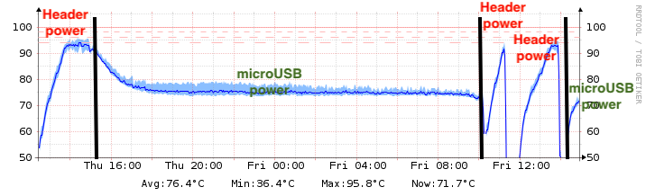

we are experiencing a strange issue:
- if the NanoPi NEO board is powered by microUSB the temperature of the board stays around 70C
- if we connect the same power supply to the header pins, the temperature of the board goes up to 90C
Attached is a RRD graph we create reading the board temp from /sys/devices/virtual/thermal/thermal_zone0/temp
Any idea why ?
I would also like to know the reason behind this different temperature readings on two different methods of powering the nanopi.
