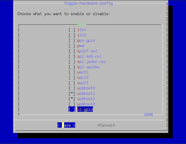

on my NanoPi Neo(2) with the silver NAS case I have enabled usbhost1 and usbhost2 and all USB Ports are useable.
see the attached Picture
