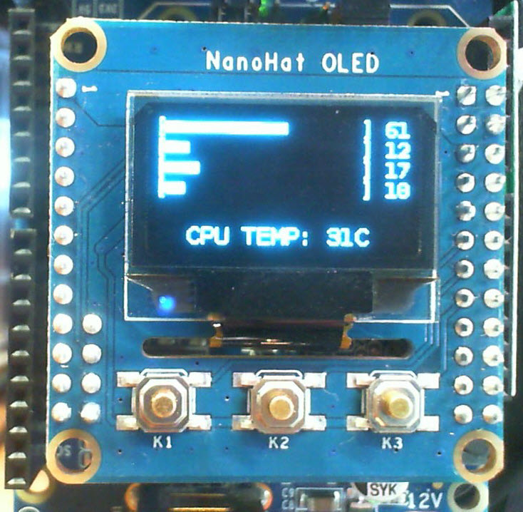

I wanted a screen that would show the CPU % of all 4 cores. Much like htop does.
I modified the bakebit_nanohat_oled.py source file. (though this forum wont let me attach a .py file. so included below.
Copy and paste into your bakebit_nanohat_oled.py source file, located in
NanoHatOLED Mine/BakeBit/Software/Python folder, and reboot.
Pressing K2 the first time will show the stock screen, pressing it again will show this new one.
Currently I am running this with my NanoPi NEO Air, the only extra step I had to do is "pip install Pillow" for it to work.
P.S. I am just scratching the surface learning embedded Linux, and Python so take it into consideration.
Image of what the OLED looks like
NanoHat OLED.jpg (146.39 KiB) Viewed 18432 times
