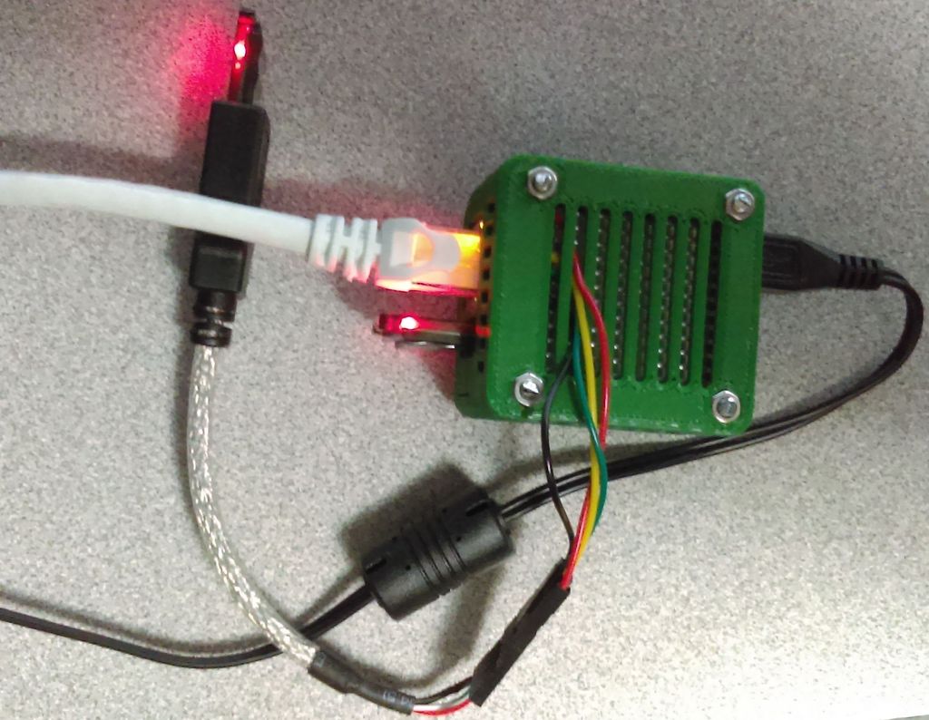

USBx2 can just plug it in?
I see Nano-Pi-NEO has 2 other USB ports the side one like real port.
2 USB-DP1 USB1 DP Signal
3 USB-DM1 USB1 DM Signal
4 USB-DP2 USB2 DP Signal
5 USB-DM2 USB2 DM Signal
If I hook them up to 2 USB plugs with the +5 and GRN will it work?
Or do I need some diodes on it or something?
Just took a chance and hope I would not mess up my NanoPi NEO.
Used jumper wires and plug them in and got it the 1st time.
Put a small SD card on the USB and it started to flash it's little LED so I was sure it worked.
Did a Fdisk -l before and after and it sees it.
Device Boot Start End Sectors Size Id Type
/dev/sdb1 * 63 7744511 7744449 3.7G c W95 FAT32 (LBA)
root@FriendlyARM:~#
Used a small SD card because I did not know if it would mess it up or not.
Pin 1 is near the SD card that plug in on the board. So it's 5 volts and at the other end is the ground. Right next to the 5 volts I plug in the D+ and next to that the D- because it says "USB-DP1" and "USB-DM1" that I guess "P" is Plus and "M" is Minus.
Here is a photo I got of it.
Wow nice can just plug it right in. It has one more USB can use too.
Got the heat sink about a week ago and installed it and the screws that come with it can't use on the case! So I had to find my own and they are hard to find. They just fit in the holes like have to screw them in to it. To long too so I cut the rest off. I have to file them down yet.
This is how it looks now.
It's working good. I copied years of my WordPress on it with video and photos too and it brings them up fast.
