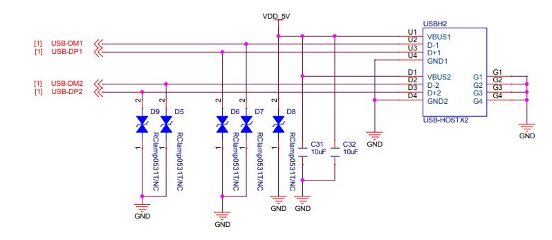

I found out what the problem was and found an error in the board schematics. This applies not only to the Nano Core 2, but also to other boards where there is no USB connector, but only the pins. And even other manufacturers. When they don't make a USB connector, they make direct lines from the controller to the pins, without any protection. In particular, they do not install ESD and because of this the device does not work.
FriendlyARM technical support asked me a question about using their mini-shield. This led me to look at the schematics of both the Neo Core 2 and the Shield. FA for USB ports uses ESD "RClamp0531T", other manufacturers most often "ESL100503". I have attached an image of the USB schematic to this post.
I had to make a similar scheme, only on the components available to me (instead of RClamp0531T or ESL100503, I used PESD5V0S1BA.115) and the flash drives worked. There is still a problem with the camera. Looking for a solution further.
OK, what a weird issue. I will try to recreate it once I find board and time.
