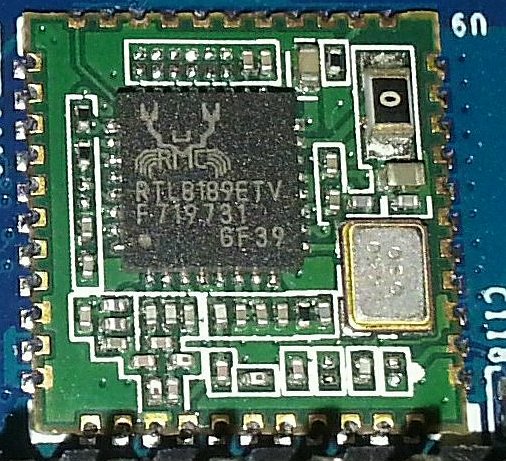

Tell me which Wifi chipset is used in NanoPI K1 Plus.

RTL8189ETV
driver
https://github.com/jwrdegoede/rtl8189ES_linux
but isnt at this time included in armbian?
couldnt see wlan0 with ifconfig in
ARMBIAN 5.59 testing Debian GNU/Linux 9 (stretch) 4.14.65-sunxi64
(and also not in my old image armbian 5.47 stable)
Isnt the rtl8189es a standard wifi module?
Attached a picture of the WiFi-Chip
Yes, it is enabled but it works only in a DEV branch. Don't know why not in 4.14.y
