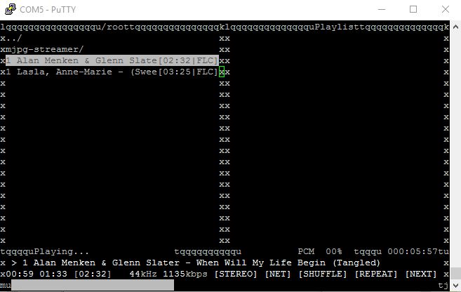

I did what you said and it still sound like junk! I downloaded a free FLAC song it seem to play good but never hard it before.
So I got the 1st CD I could find were I would know what the song sounds like. Disney Tangled When will my life begin. Used Windows Exact Audio Copy to made the one song from CD to FLAC. Copied to to /root of my NanoPi Net with the HAT.
It started out good but when she starts to sing it can hardly hear it!

I don't know the reason, How many NanoPi NEO do you have? Every one hardly hear the sing?
-- Mindee
I don't know the reason ether. I guess something is bad on the NanoHat. I have one more NanoHat on a NanoPi Air. It sounds good.
