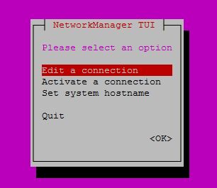

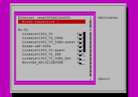

Used a DD command to copy the image to the eMMC so I had to start over. This time I found out what get's it on WiFi.
The /etc/network/interfaces file. I just did a cp /etc/network/interfaces /etc/network/interfaces~
Then vi /etc/network/interfaces and clear it all out what they have in there and copied a past the other post I put before this one.
nmtui easy command line WiFi.jpg (15.71 KiB) Viewed 50519 times
Got down one to Activate a connection and you see this at lest this is the WiFi mine picks up.
nmtui easy command line WiFi list.jpg (41.2 KiB) Viewed 50519 times
That would make it easy to set up WiFi and this nano pi air image should have that in it because besides RS-232 that is about the only way to connect to it.
Now that I have mine working good with room on the 8GB eMMC can install things. I installed the apt install network-manager Took a wile to install all it needed. But it worked.
After installing it had to start it.
service NetworkManager start
But go to activate and it's all blank on it's WiFi.
Rebooted and still did not fix it. I guess that's why they did not install it. Even the change hostname don't work on it. Just says did not change it.
