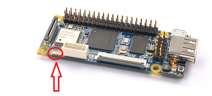

We have to admit that the overall performance of the NanoPi WIFI is not very good.
As for the AP issue you can try removing the connector shown below and solder an antenna
As for the wifi client issue our Debian by default is set to WPA so if the AP is WPA2 it might not work. You can set it to WPA2 and try again.
