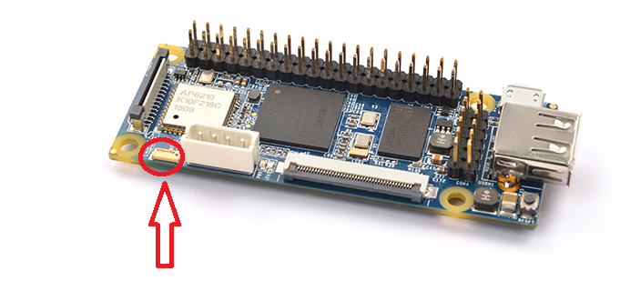

As for the AP issue you can try removing the connector shown below and solder an antenna
