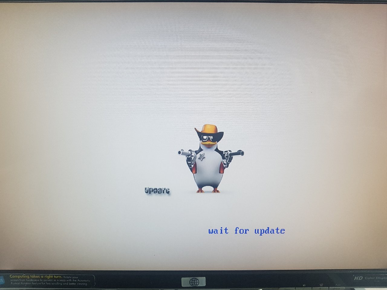

I just received a Nanopi S2 with Android installed. However, I wanted to flash it with Debian or Ubuntu, so I download the file: s5p4418-eflasher-sd8g-20171017-full.img and followed the instructions according to the wiki: http://wiki.friendlyarm.com/wiki/index. ... et_Started
The problem is when the board is powering up, a TUX cowboy image appear with the legend: "Wait for update". After an hour an a half, nothing happens and the image remains there.
Tux cowboy
Is that normal? According to the wiki an selection screen must appear when you use the e-flasher, right?
What should I do?
Thanks in advance.
I finally solved the issue. I started over again, but this time I use the official SD card formatter and copy the image again and this time it worked.
